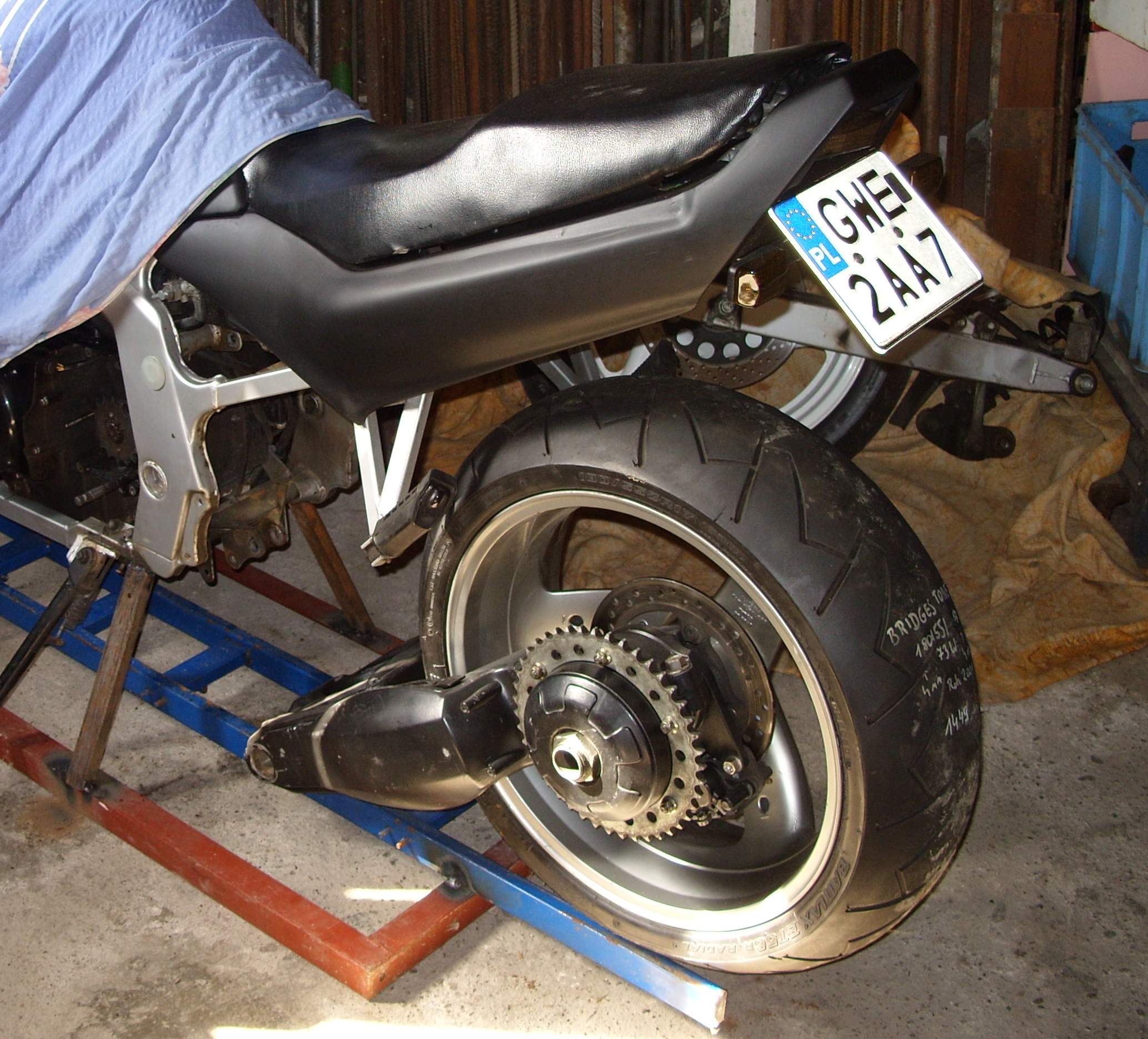

The weather is bad and I've started my umbau earlier MONO,USD, and bodywork
MONO first (problems)
-frame need to be modificated
-I need new custom output shaft (about 30mm longer) my freind is going to made it for me
-rear sprocket need to be modded (from almost 9mm to 6mm) triumph one is too wide GS chain is thinner
-the most difficult I'm finding modification of the clutch mechanism I've some ideas but it's goona be the hardest thing in whole project
more pics and details later
