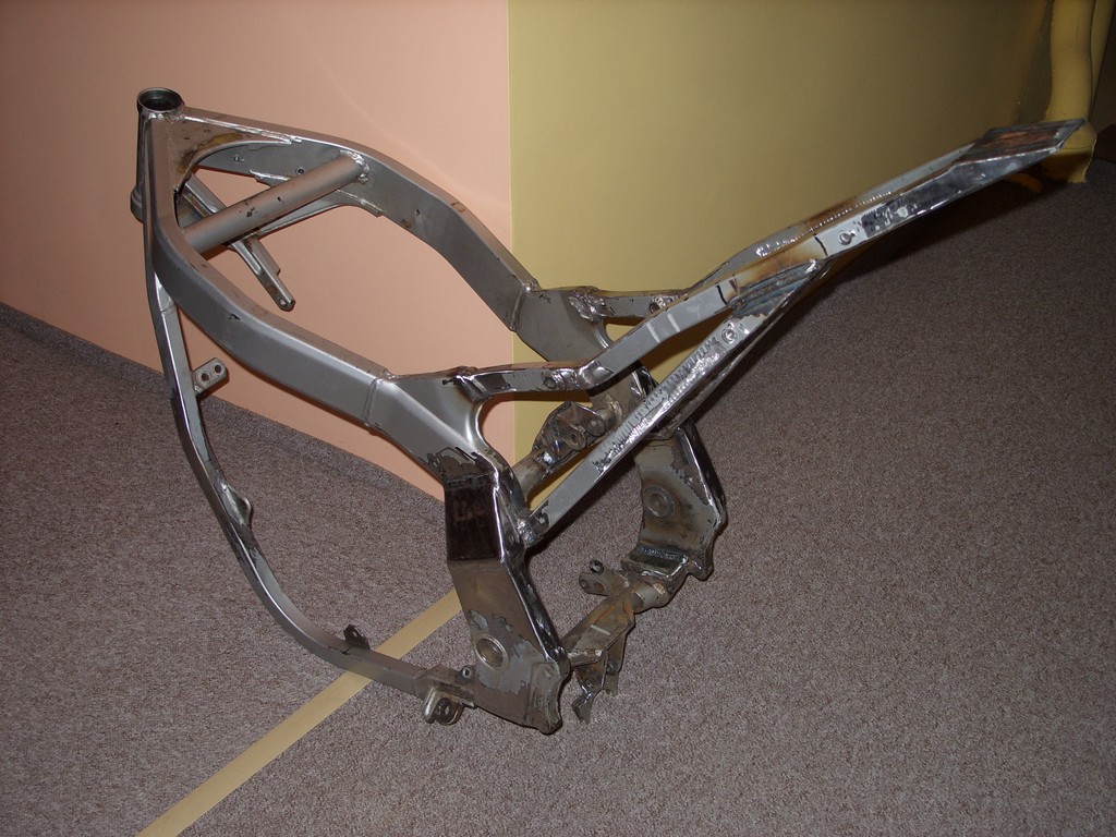

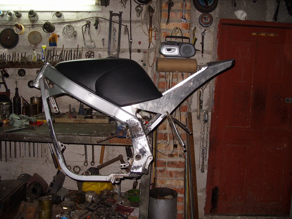

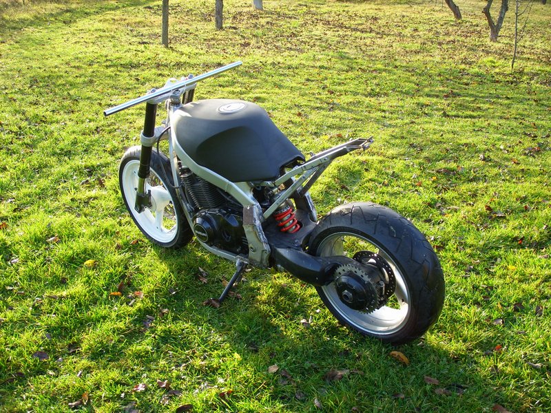

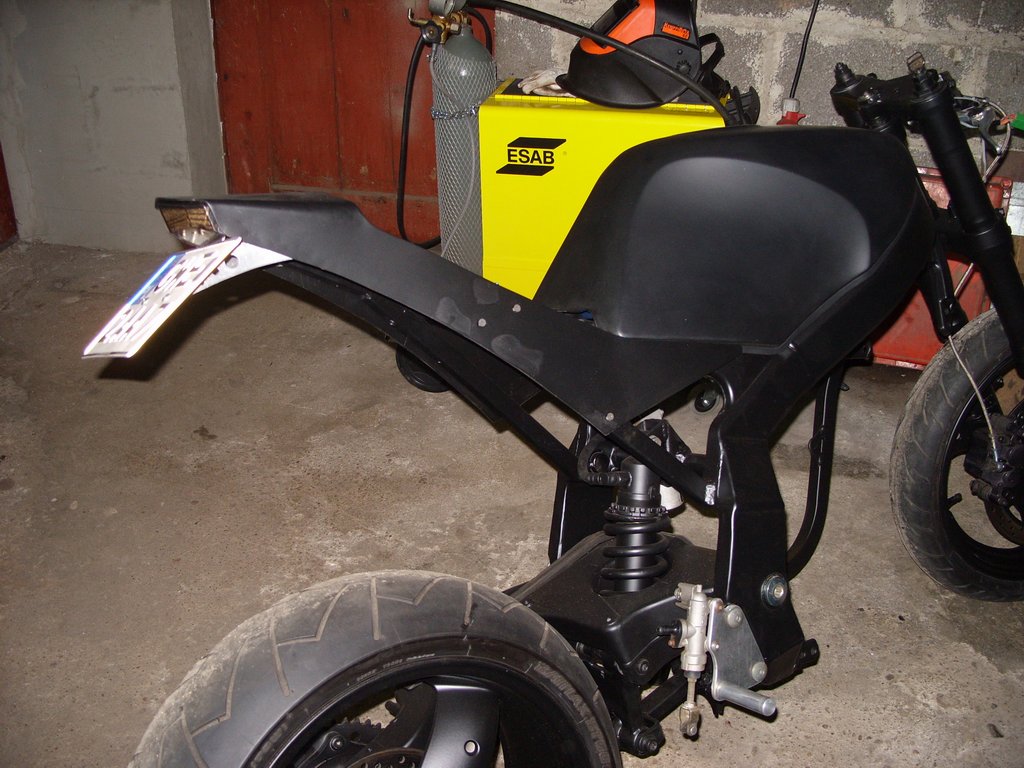

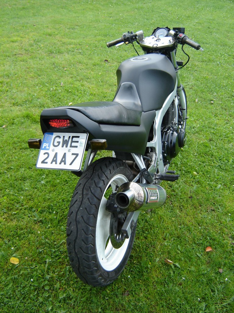

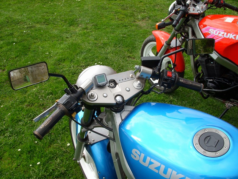

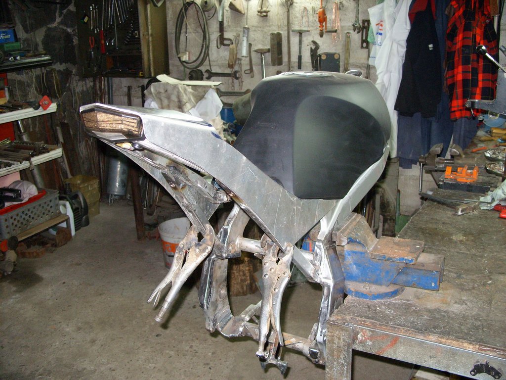

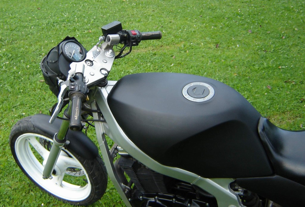

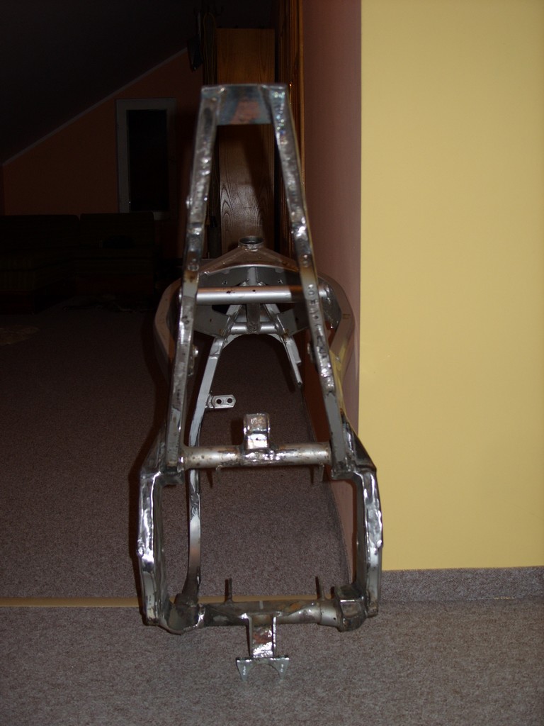

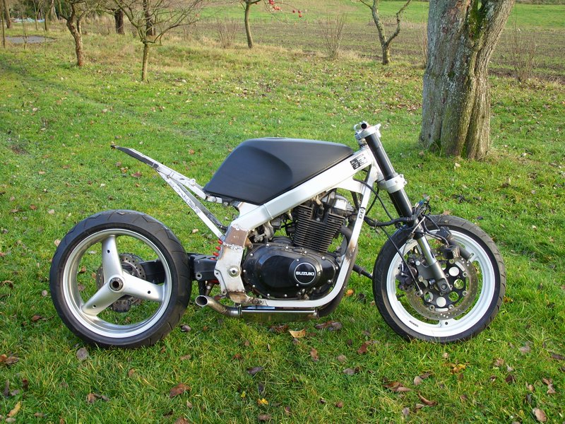

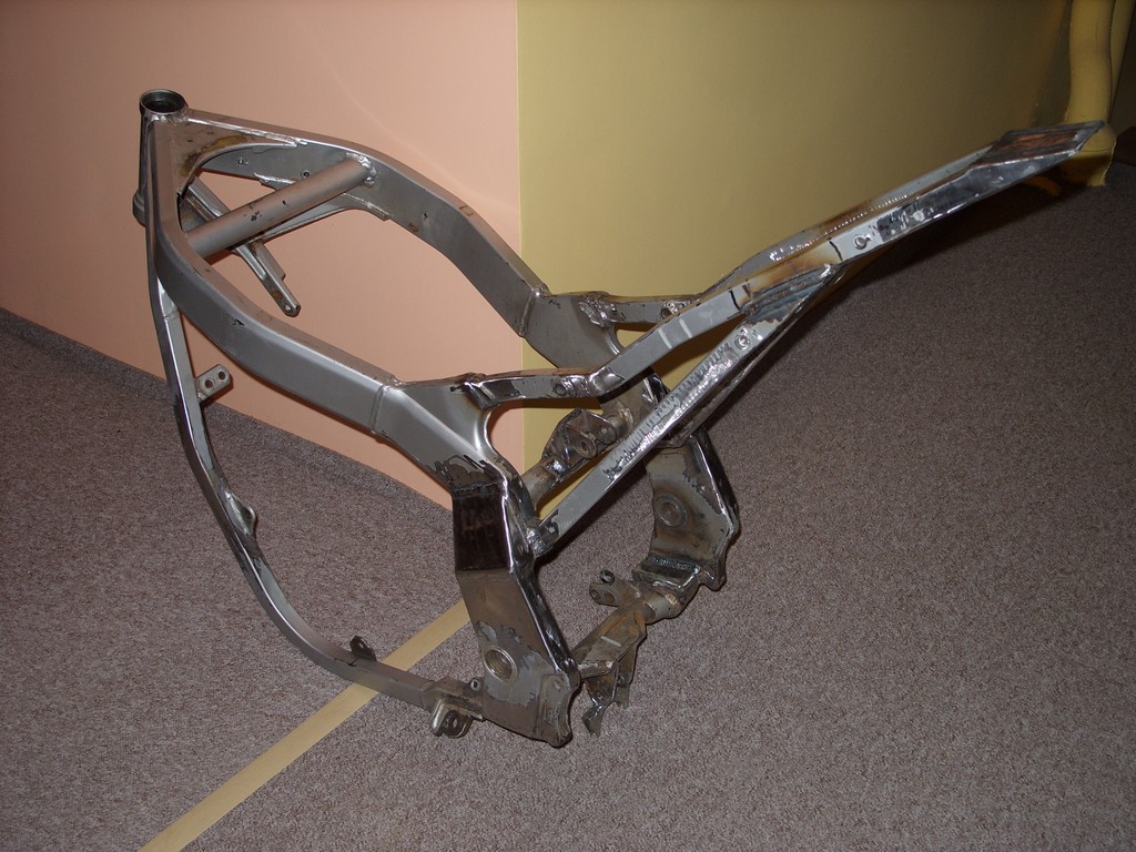

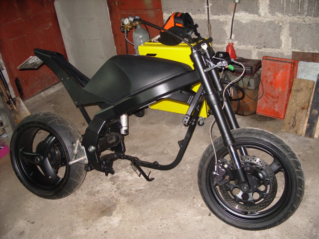

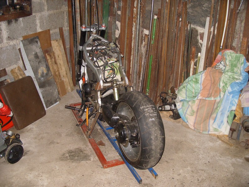

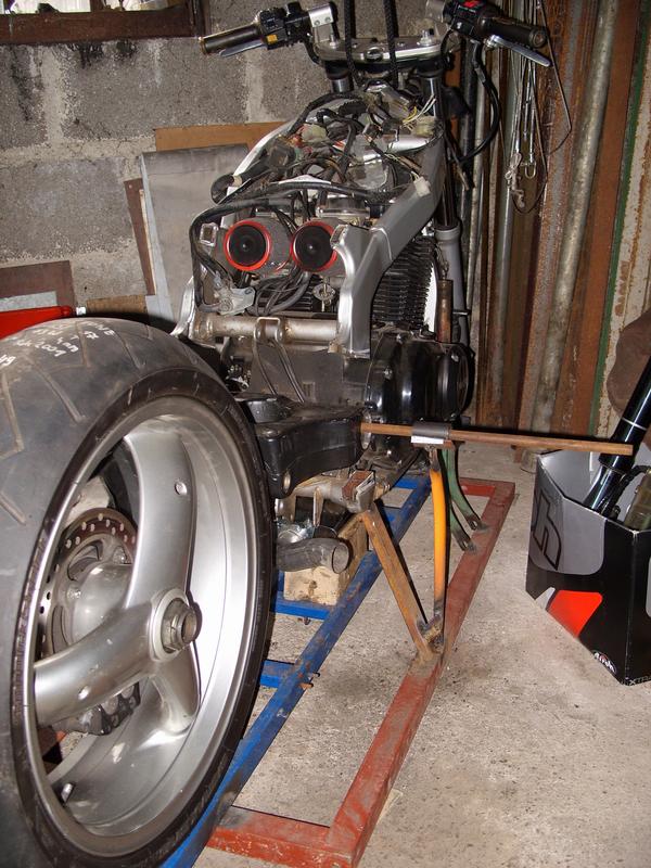

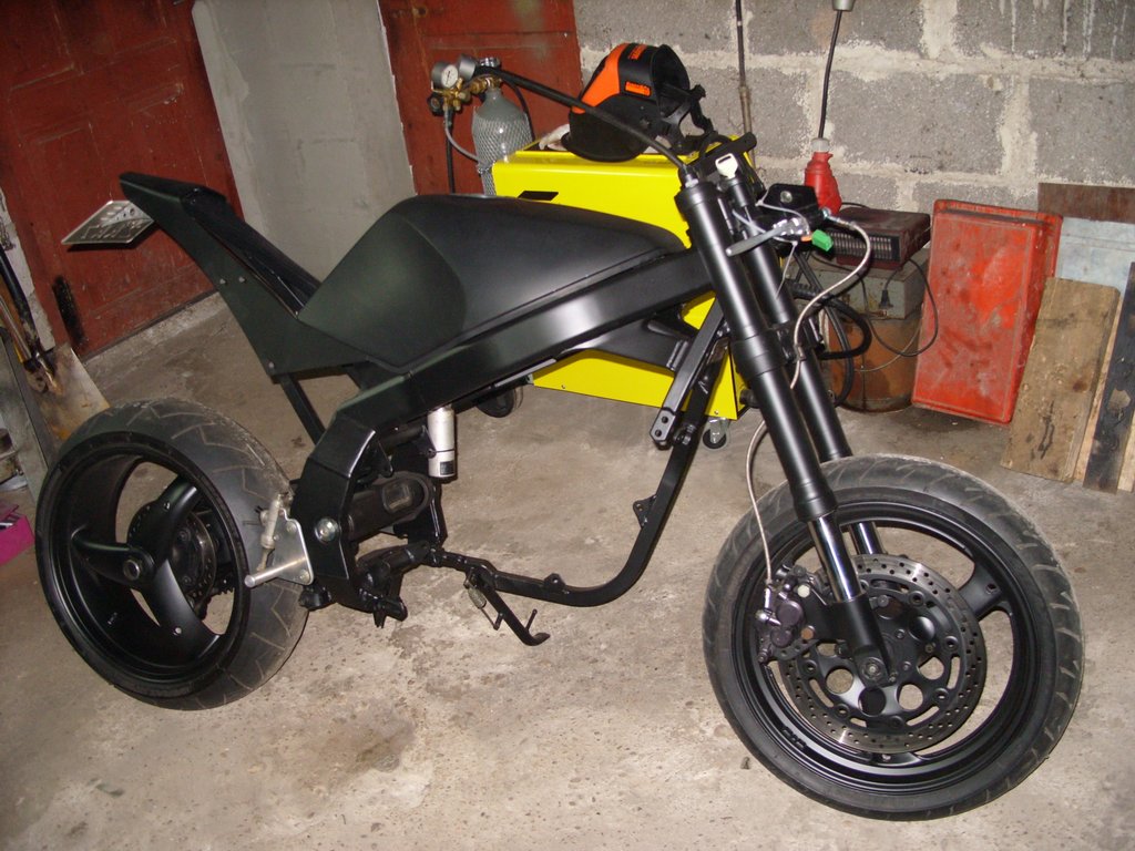

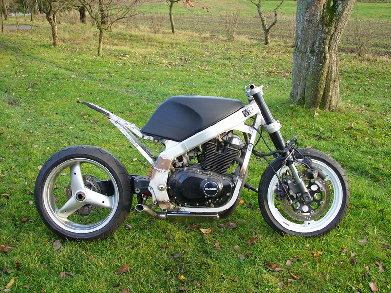

Hi my name is LUKAS I live near 3city in Poland. I'd like to show you my GS. I bought it in march and tunned a little bit That's all for today but I'am going to do a lot more in the winter. I really like your forum and your bikes, especially tunned ones.

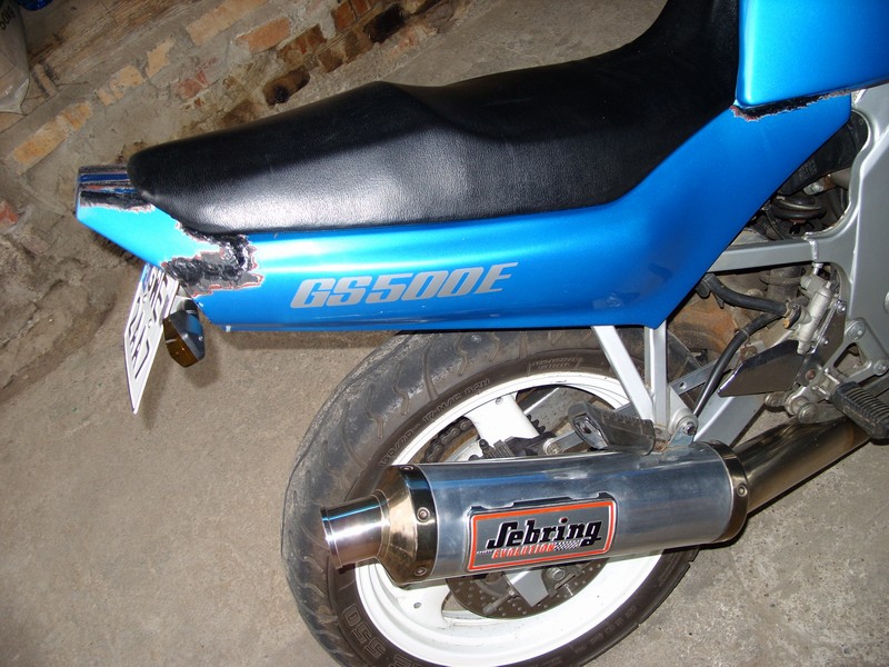

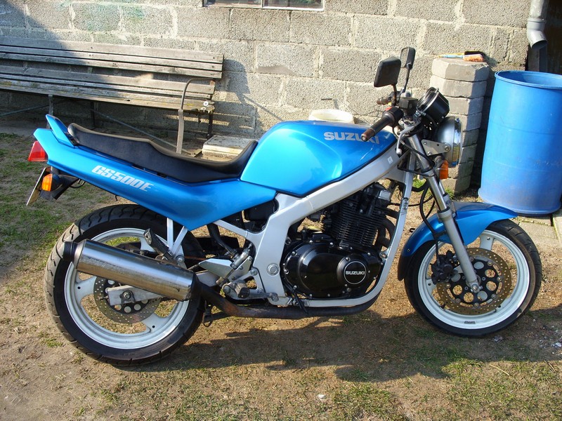

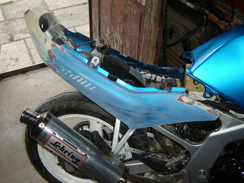

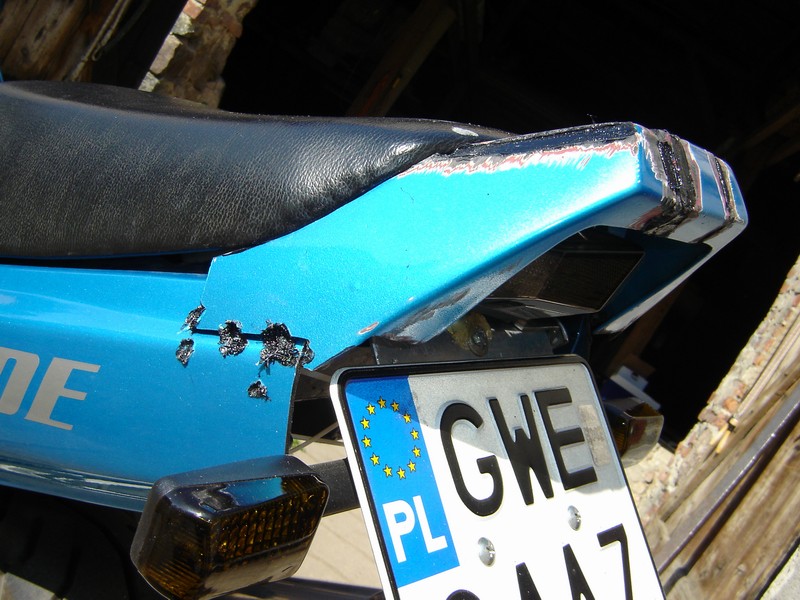

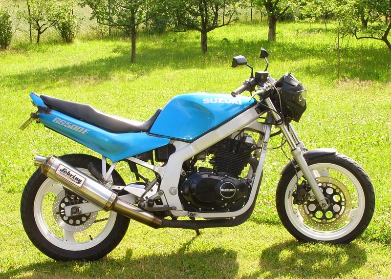

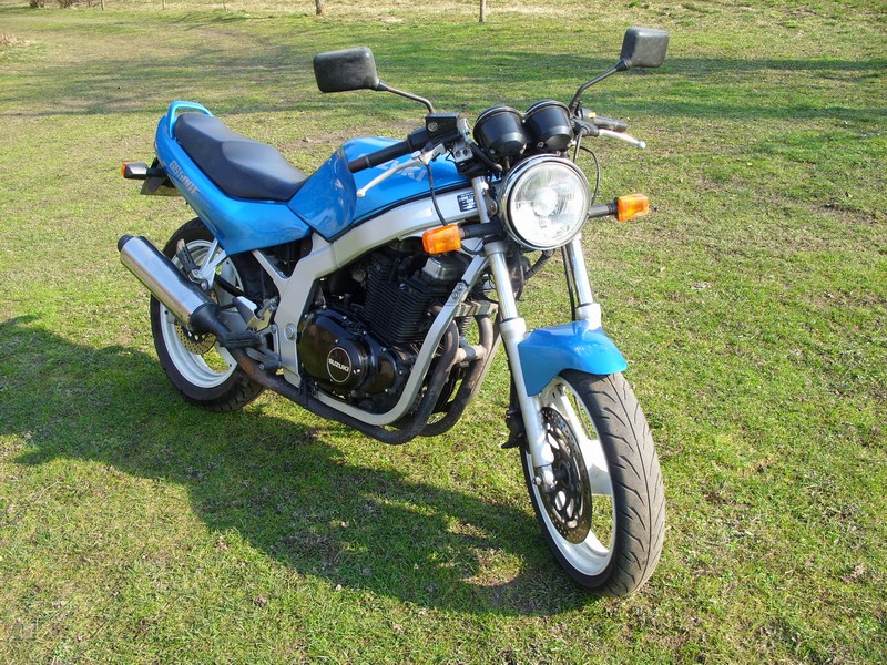

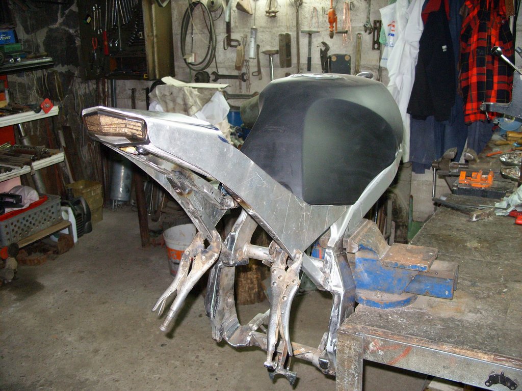

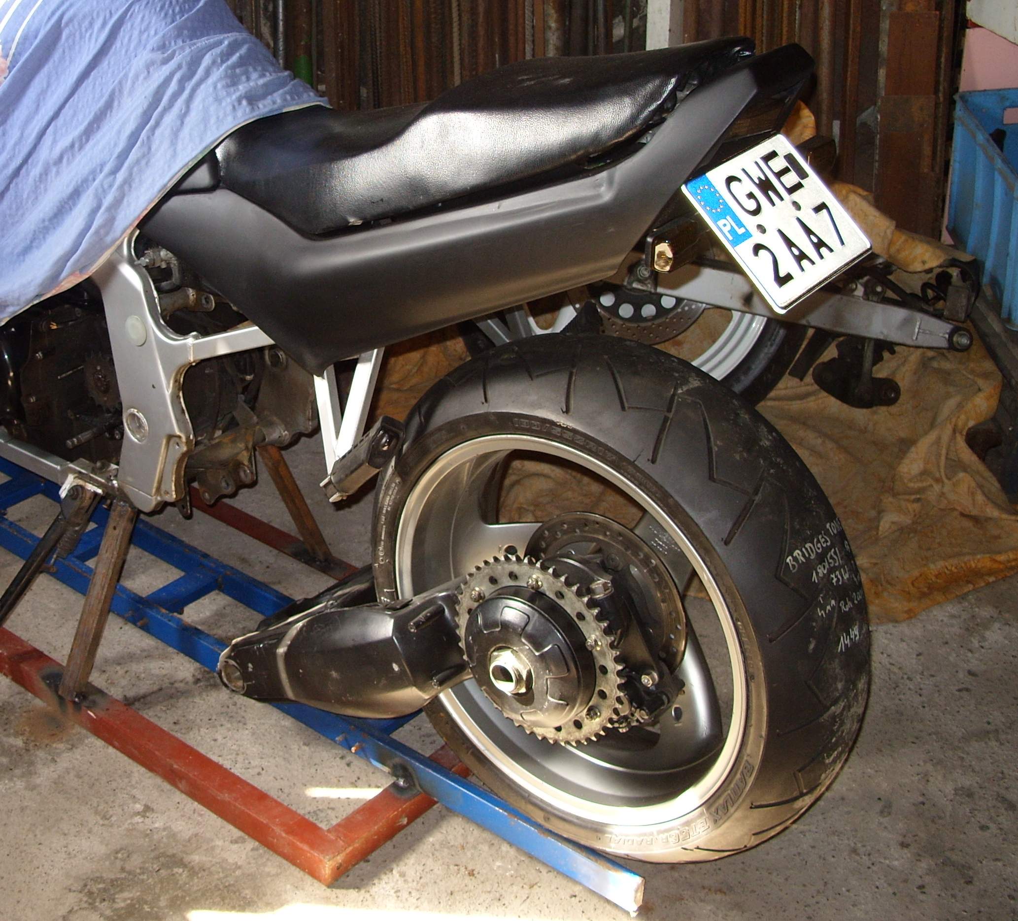

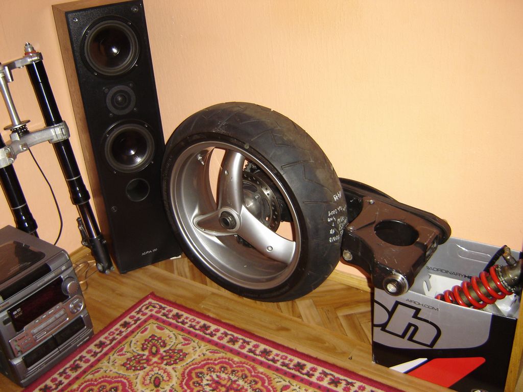

Some more pics. (on two first photos you can see how it looks when I bought it)

really nice! good work

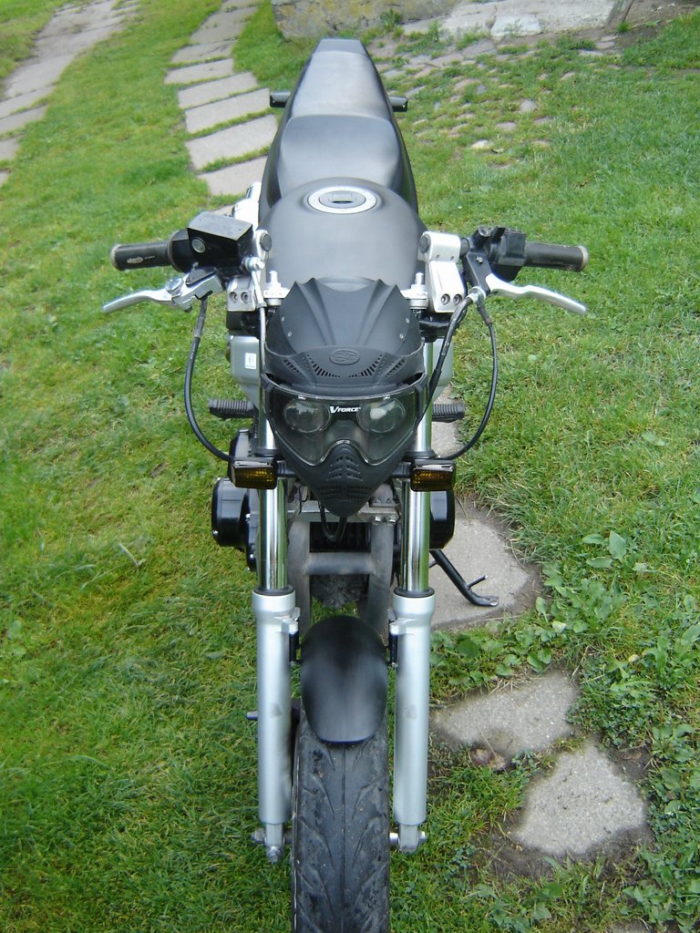

good work! the mask is pretty cool

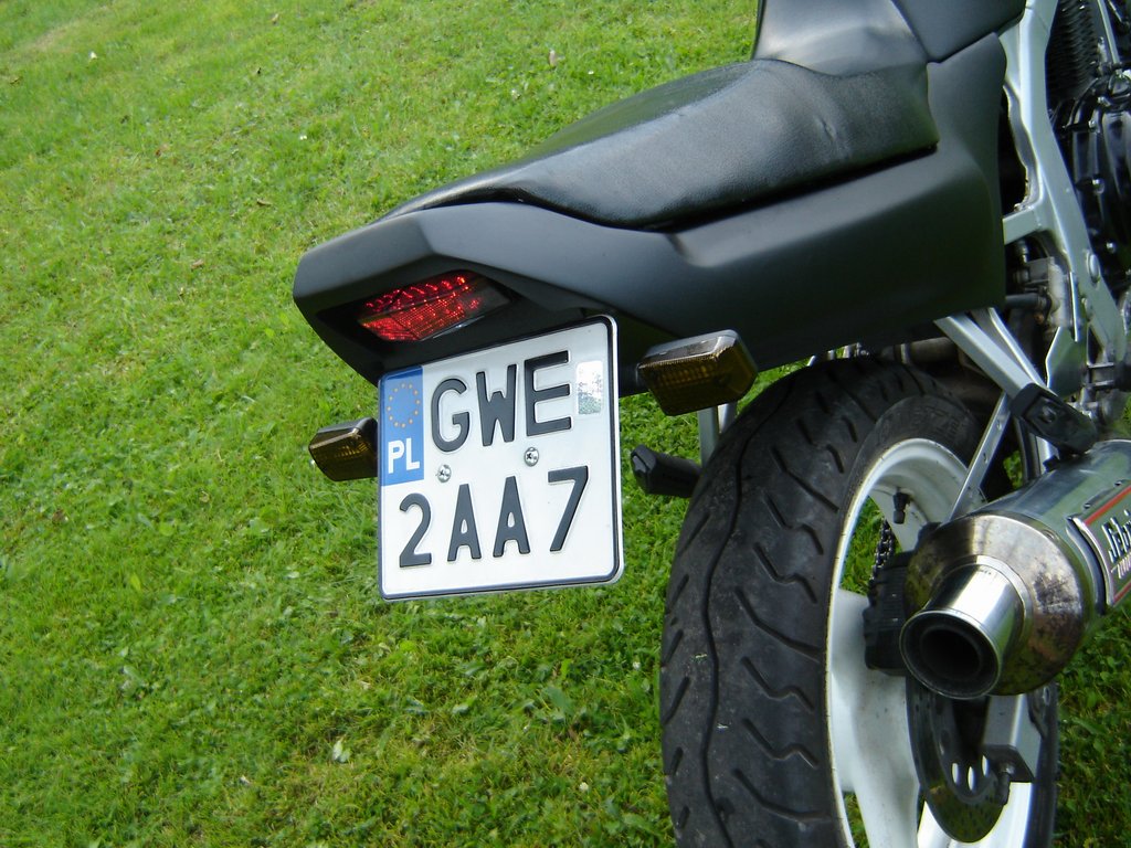

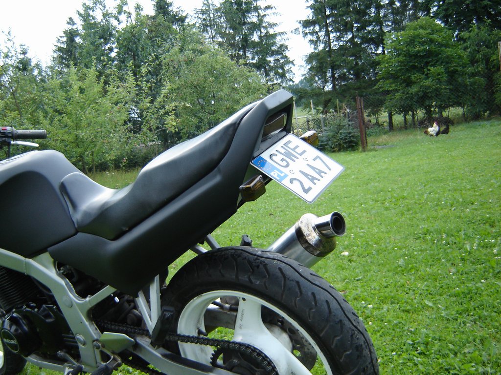

the rear end looks pretty cool!

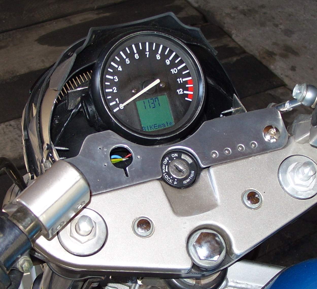

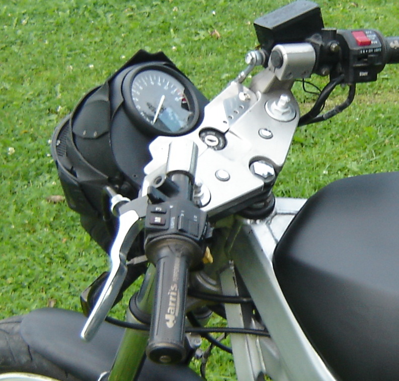

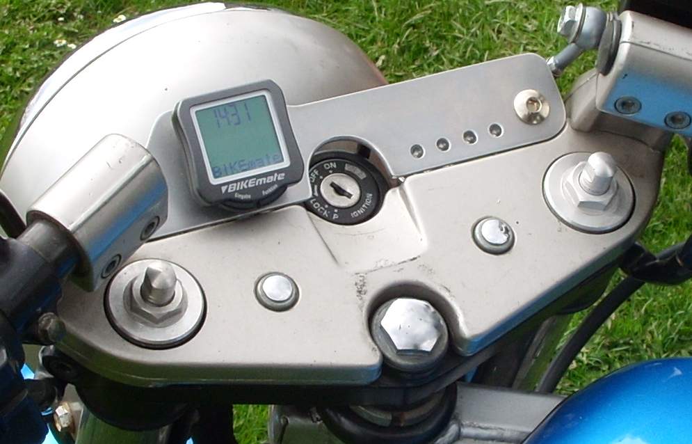

Your rev counter is very interesting. Is it a Speedometer inside ?

some interesting new inventions like the back and the indicators panel & speedo kicks ass!

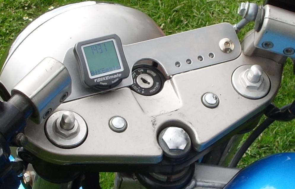

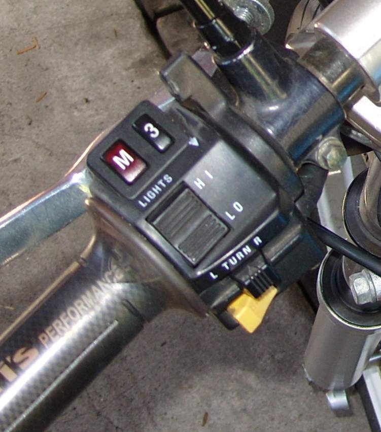

Standard Re: GS from POLAND
Yes I've put it inside and function buttons I've hide on the left side of the bar.
Zitat von fizoduck
i just recognized ur missing the little metal plate over the fender... u should aply that back incase u dont wanna twist ur forks!
Thanks mate it's a good tip, I didn't think about that because many bikes dont have it, but you may be right. Anyway in the winter I'am going to apply new fork (he is waiting in my room with new mono swingarm) and fender too

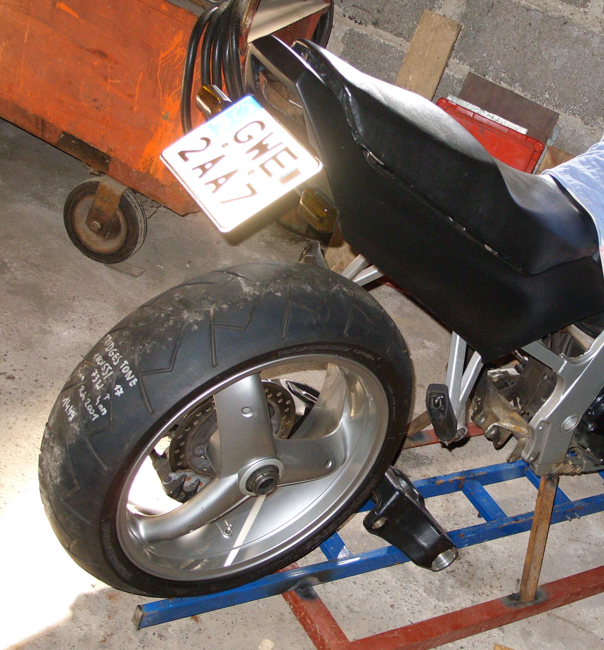

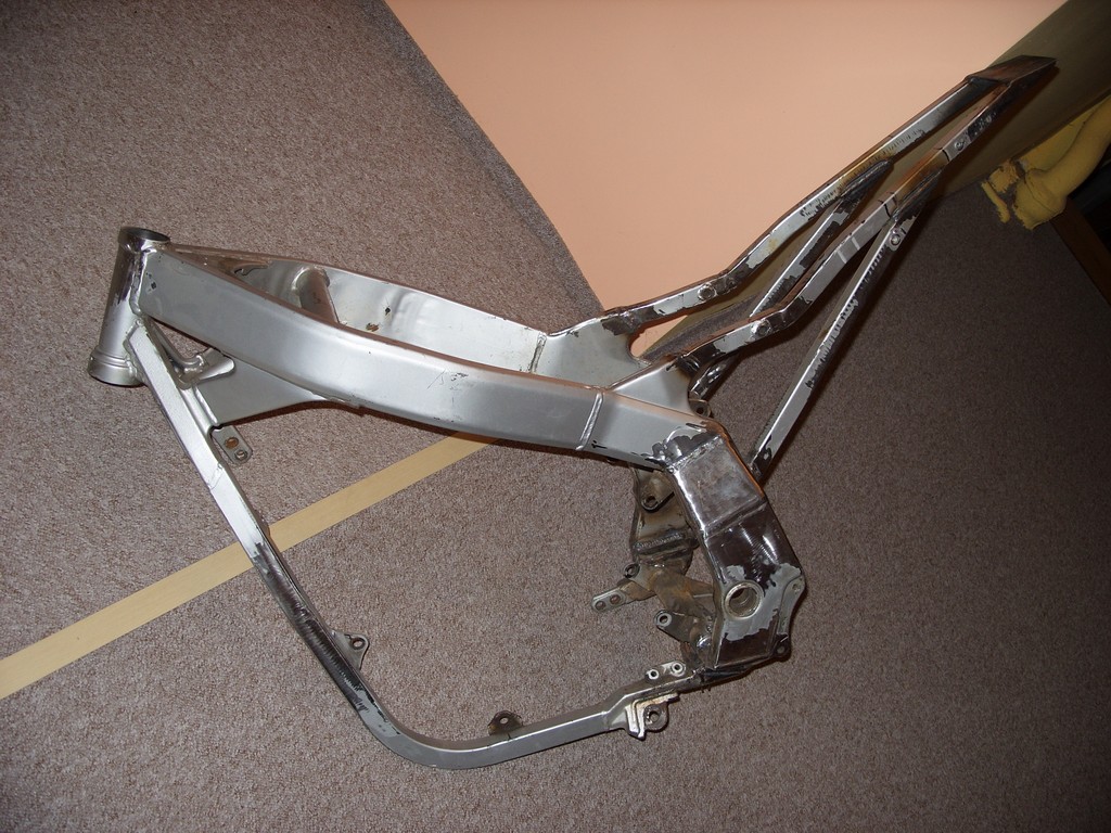

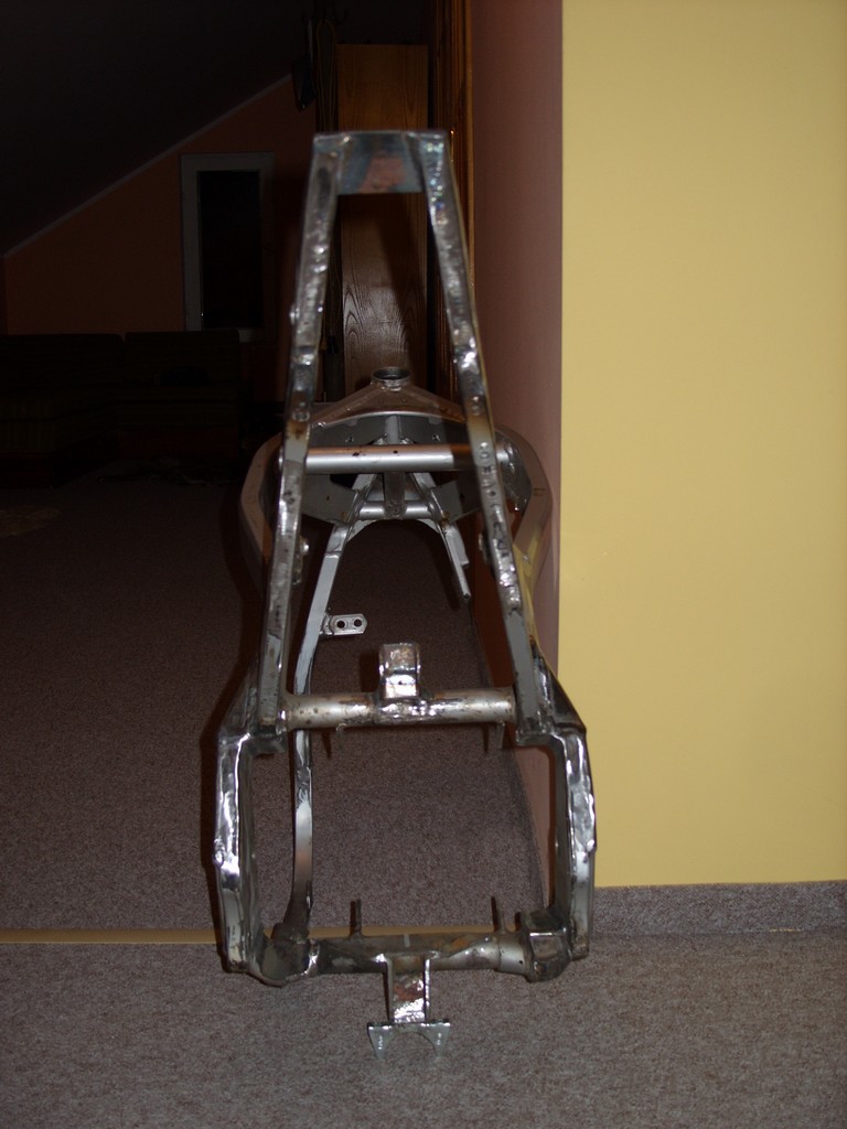

How do you want to mount the ducati swing arm into the gs? It is about 4cm to wide for the gs frame
Alt 28.08.2008, 01:26:28   #12
CZOKO
Benutzerbild von CZOKO
Registriert seit: 27.08.2008
Beiträge: 44

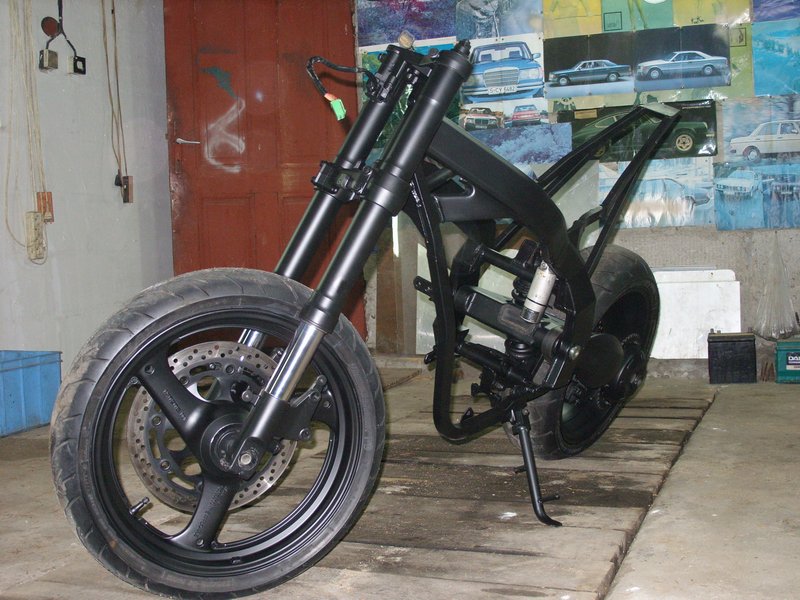

It's mono from Triumph (it's not plug and play this operation wan't be easy but it i can handle it)
On polish GS forum they wasn't soo enthusiastic about my bike They think that GS is cool only in original, they can't understand why I'am modding it. I've owned few bikes and ride many before, with many more ps too but I want to build my own bike and for my project I choosed GS because of it's advantages. My favoured inspirations I'am always looking in your country GERMAN STYLE RULEZ

Zitat von CZOKO
Yes :) I've put it inside and function buttons I've hide on the left side of the bar.
Could you provide a little more detail on how you did this?
Cherry
Alt 28.08.2008, 09:14:07   #14
CZOKO
Beiträge: 44
I sold my oryginal rev and speedo (for about 100 euro) to a gay who crushed a lil bit his GS he gives me his rev (a bit damaged) as a bonus I bought a digi for bikes (scaled to 199km/h for about 10 euro) and try it on, but it didn't look nice soo i put digi speedo in pieces and lcd placed in rev that I've easily repaired and made new buttons on the left side of the bar for changing functions (trip, dist, temp, time, etc) of the speedo and connected it by wires. I'am testing it for about 3000 km till now and everything works just perfect.
PS sorry for my english it's not too good i hope you will forgive me, I speak a lil bit german too

I like your speedo and the neccessary work sounds not to be very difficult.
same problem with the triumph swing arm ... how do you exactly plan to modifiy it?
a friend of mine has a tirumph swing arm on his bandit ... he cut the swing arm in half, removed the middle part and welded it back together....
Sorry, but you didn't understand me I know that this swingarm will not fit in the GS frame. I've got some expirience in modding, it is not my first umbau but this will be the most dificult. I'am going to modify back of the frame and this shaft with sprocket and it is the only way I can fit it in. Modding the swingarm is useless because I will have 180 tire at the back. I'am starting in winter don't worry I put some photos leater .
I hope you will not be angry at me, but I think it is not a good way to fit it in, because if you remove middle part of mono the wheel will not be in center line of the bike. In bandit serial tire is 150 or 160 (i don't remember) it is 20 or 30 mm difference between triumph's 180 in GS this diference is 50 mm and if I want to do it PRO frame needs to be moded to get enaugh space for chain.

your rev-counter is class and the buttons on the grips are tidy work....

I don't normally like the "fighter" masks...yours looks like its from the paintball (gotcha) area!!!
Yes you got me it's a paintball mask It looks quite nice but I'am selling it next week to my friend (to his supermoto) he freaked about it Anyway I need to build something new for wider forks but I've no idea what it's gonna be maybe somethimg less agresiv and more classic naked this time.
Is it possible to do this modification in Germany? My Speedo is damaged an i like this mod, thought i could do the same on my bike. But i'm curious if there will be any problems with the TÜV?
<- verdächtig viel
Alt 02.09.2008, 07:53:19   #24
Alter: 51
I recommend strongly to talk to an "Expert" of TUEV/DEKRA bevor you start. If you use an e-signed speedo there won't be big problems, using speedos without e-sign will work most times, too. But ingeneers want to know exeactly what you've done.

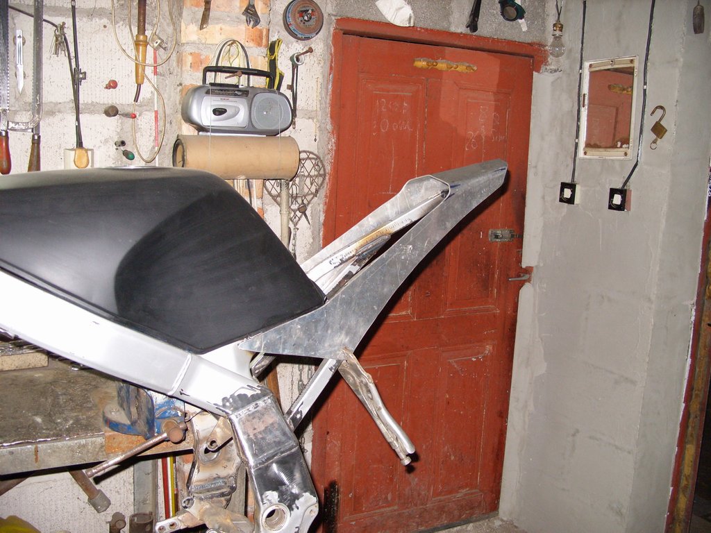

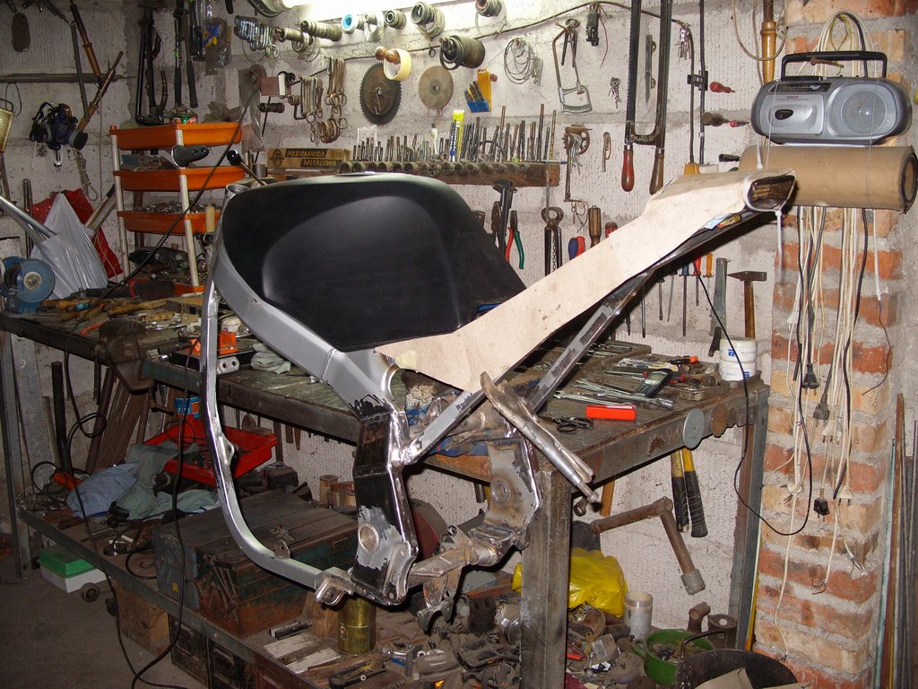

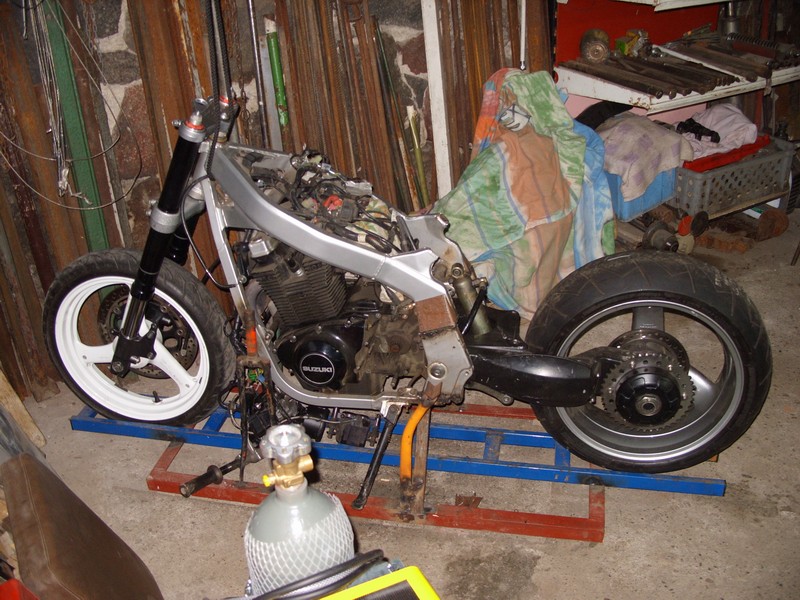

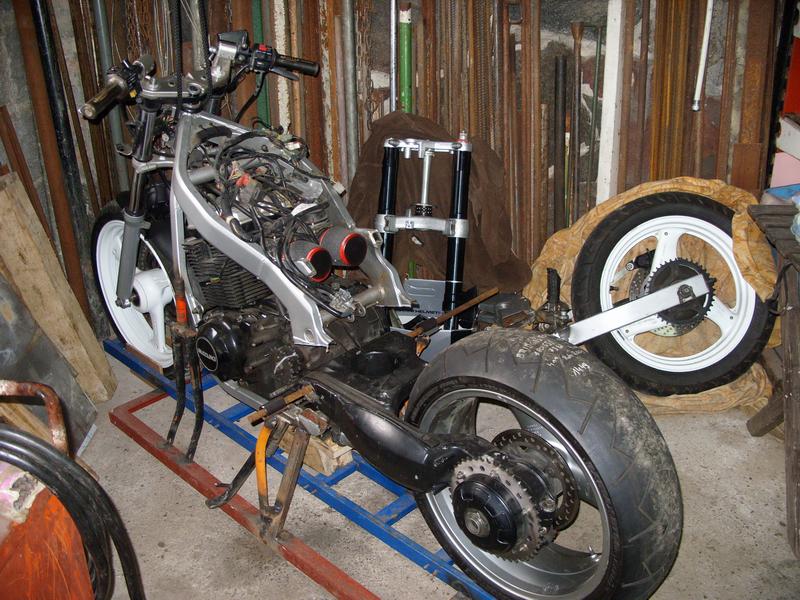

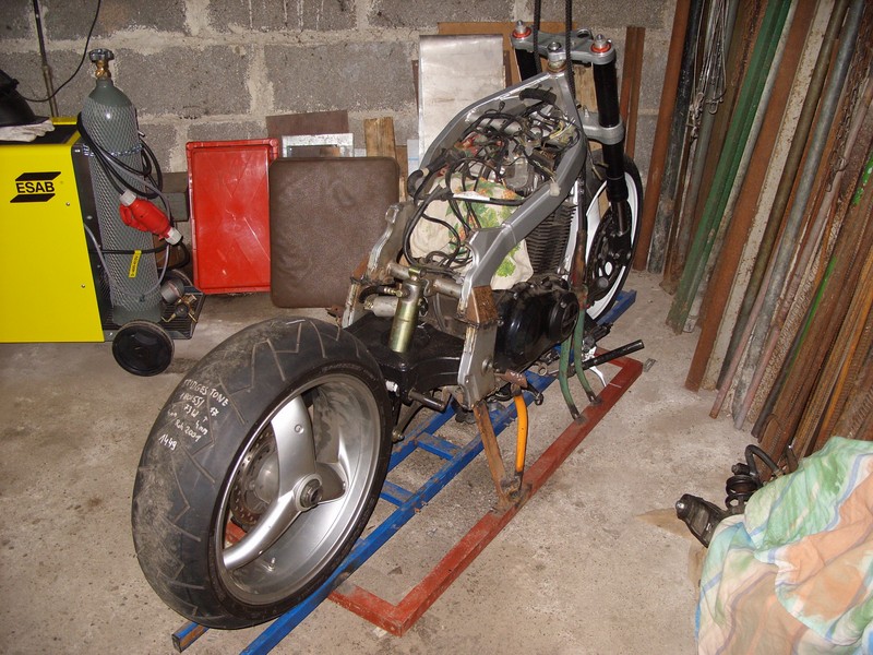

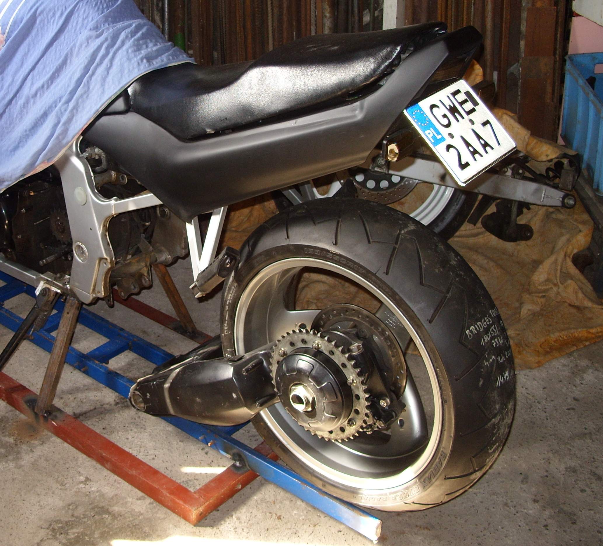

The weather is bad and I've started my umbau earlier MONO,USD, and bodywork
MONO first (problems)
-frame need to be modificated
-I need new custom output shaft (about 30mm longer) my freind is going to made it for me
-rear sprocket need to be modded (from almost 9mm to 6mm) triumph one is too wide GS chain is thinner
-the most difficult I'm finding modification of the clutch mechanism I've some ideas but it's goona be the hardest thing in whole project
more pics and details later

I also have a question about the speedo...
how do you do the battery change? Do you have to detach the whole thing or do you have the battery at a different place?
And what about the lighting of the speedo? I have the same thing and it has this light function. But this needs lots of battery capacity. How did you solve that?
Btw: great work!!

I've made a new place for battery. I can change it from outside without putting in pieces the rev (I'm gonna show you fotos of it when I take some) You are right original light of this speedo is very uncomftable I've prepared original GS's rev light to do the job.

Name:	102 SS851295.JPG
Hits:	3762
Größe:	106,7 KB
ID:	1957   Klicke auf die Grafik für eine größere Ansicht
Name:	103 SS851296.JPG
Hits:	1129
Größe:	99,3 KB
CUSTOM DON'T COME IN A BOX !!!
CZOKO ist offline   Mit Zitat antworten
Alt 13.10.2008, 16:05:09   #29

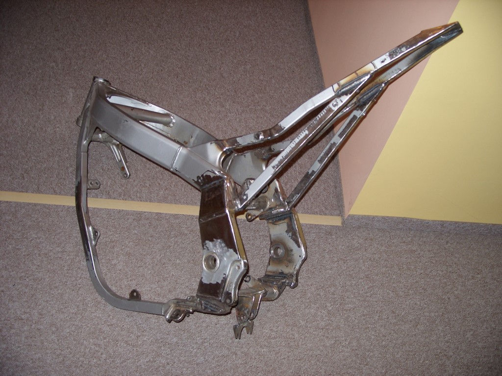

iieeew...not quite gentle...I´m pretty anxious how You´re going to fix that.
Currently I can´t imagine a durable and accurate solution...
Edit:
But the mounting of the frame looks good!
Alt 15.10.2008, 23:34:00   #30
Bonesplus
Registriert seit: 24.07.2007
Ort: 29664, Walsrode
Beiträge: 114
Kilometer: 58000

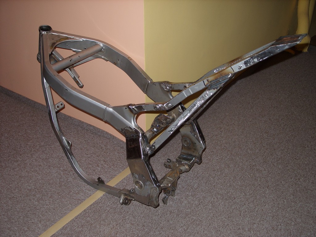

not sure if you have noticed, but someone has stolen a bit of your frame!!!
That would to the untrained eye look extremely drastic, but to the trained eye....how will you close the gap? what erm bike will you use?
May the fleas of a thousand camels infest the crotch of the person that made your day bad, and let their arms be too short to scratch.
Bonesplus ist offline   Mit Zitat antworten
Alt 16.10.2008, 11:20:25   #31
Just the fill of the gaps is not the most difficult part (weld some trapezoid plate on).
But to complete the frame You've got to work utterly meticulous to assurethe whole geometry and rigidity.
And what about the alignment of the chain?
Alt 05.11.2008, 16:03:26   #32
CZOKO
Beiträge: 44

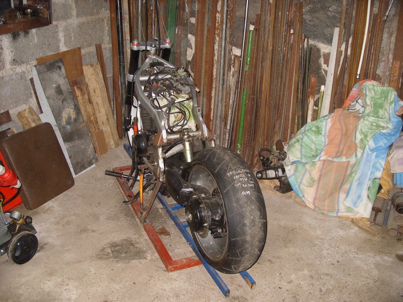

Hi a lil update is ready! I'm on a good way to solve problems that you've mentioned. About geometry after I point welded ... I've measured it few times and my subframe and preparations before I've cutted the frame worked very well. More details later.
See ya

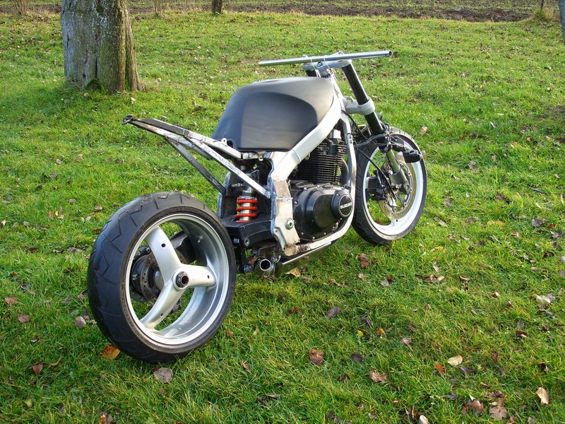

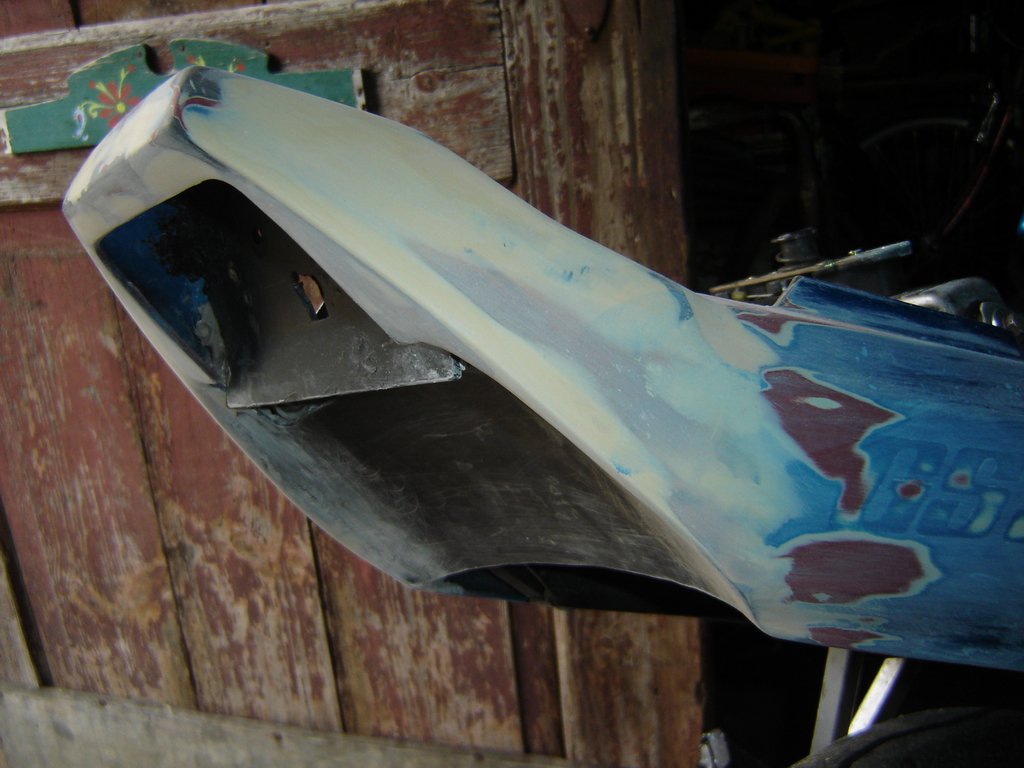

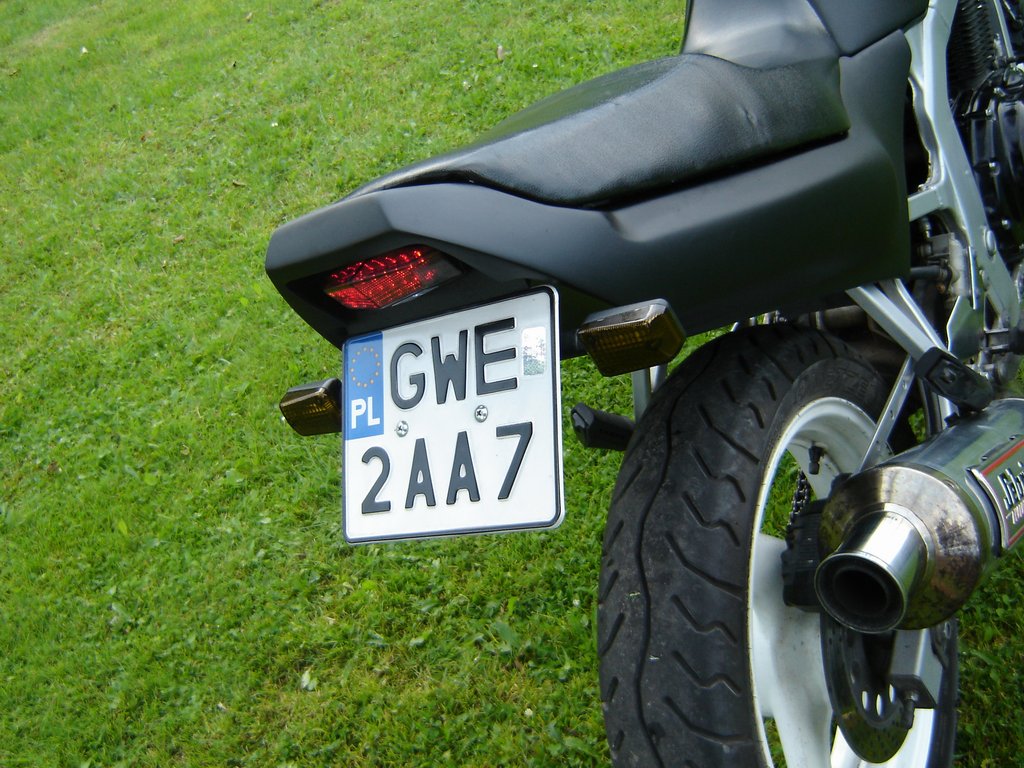

Rear suspension linkage need a bit mod, my tail is too low , but I'am quite satisfied now sprocket and clutch pusher
PS great Thanks to my friend Simon H for help with some custom parts
..looks pretty cool
...keep it up !
...thats just sick ...
...I'm looking forward to see that thing finished...

Looking good....will you blend in the bottom of the frame the same as the top where you widend it?
stikes me as very "Buell" in the shape as it stand now...what are your plans for the rear?
good work.
looking forward to seeing the completed job.

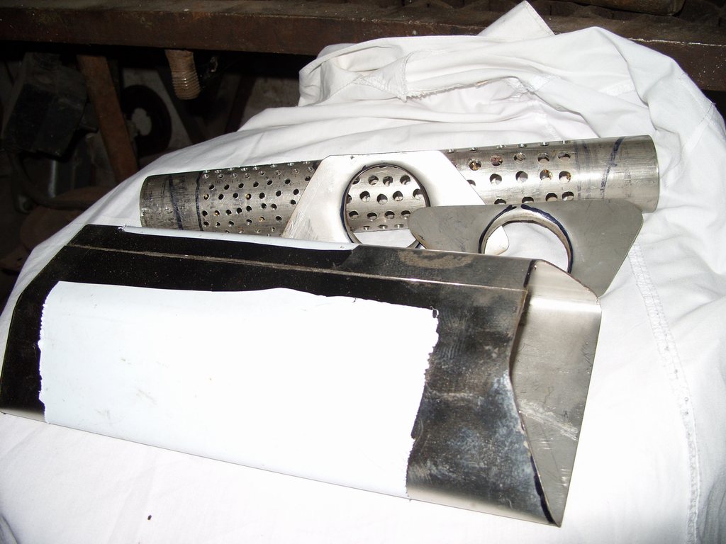

Naturally, I've got all prepared but I want to take engine out of the frame and do the final welding on the table to keep good quality of my work
PS my silencer

Beiträge: 44

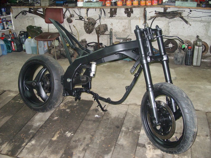

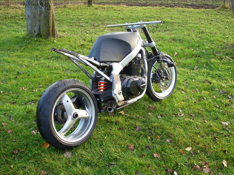

Frame is ready! Now time for engine

Looks good!
Nice work!!

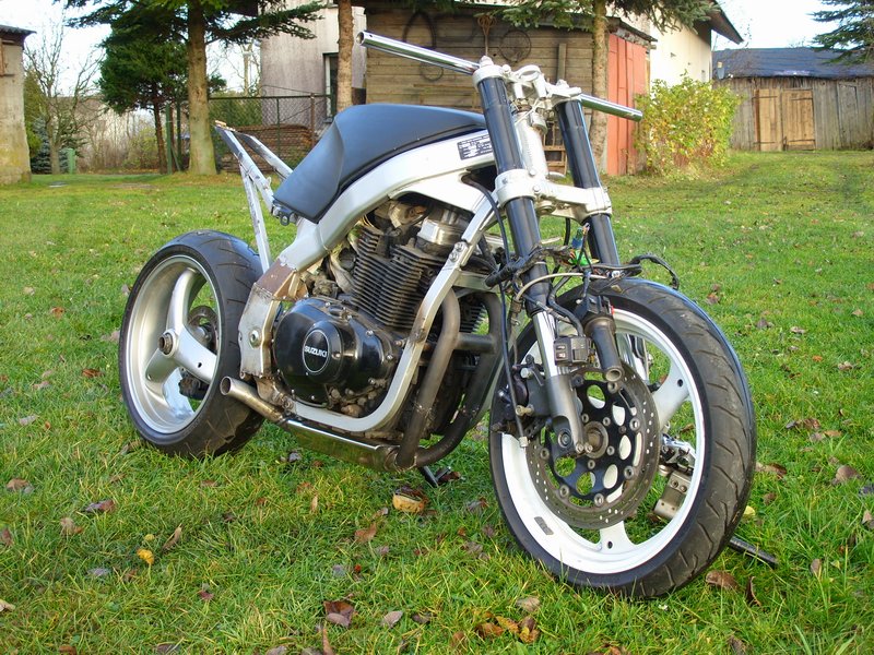

final painting after some testrides (hopefully in january).

I´m anxious where You´ll hide Battery an the electricals...
