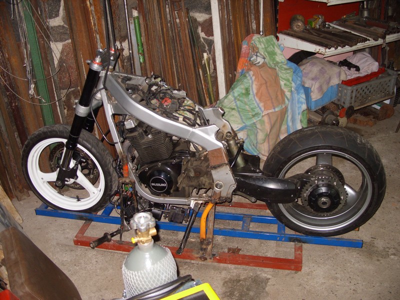

Some more pics. (on two first photos you can see how it looks when I bought it)

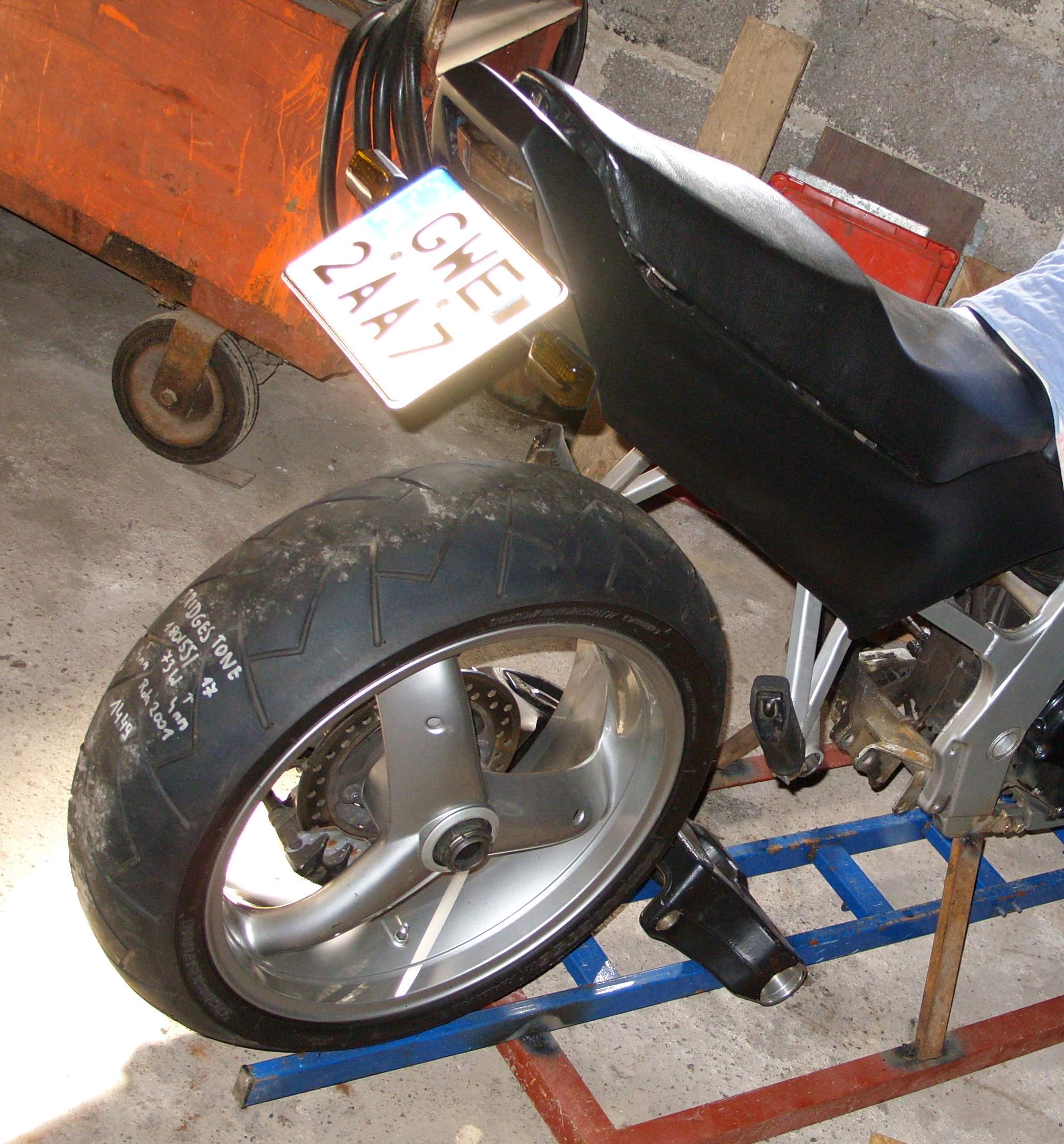

How do you want to mount the ducati swing arm into the gs? It is about 4cm to wide for the gs frame

It's mono from Triumph (it's not plug and play this operation wan't be easy but it i can handle it)

same problem with the triumph swing arm ... how do you exactly plan to modifiy it?
a friend of mine has a tirumph swing arm on his bandit ... he cut the swing arm in half, removed the middle part and welded it back together....

Sorry, but you didn't understand me I know that this swingarm will not fit in the GS frame. I've got some expirience in modding, it is not my first umbau but this will be the most dificult. I'am going to modify back of the frame and this shaft with sprocket and it is the only way I can fit it in. Modding the swingarm is useless because I will have 180 tire at the back. I'am starting in winter don't worry I put some photos leater .
I hope you will not be angry at me, but I think it is not a good way to fit it in, because if you remove middle part of mono the wheel will not be in center line of the bike. In bandit serial tire is 150 or 160 (i don't remember) it is 20 or 30 mm difference between triumph's 180 in GS this diference is 50 mm and if I want to do it PRO frame needs to be moded to get enaugh space for chain.

The weather is bad and I've started my umbau earlier MONO,USD, and bodywork
MONO first (problems)
-frame need to be modificated
-I need new custom output shaft (about 30mm longer) my freind is going to made it for me
-rear sprocket need to be modded (from almost 9mm to 6mm) triumph one is too wide GS chain is thinner
-the most difficult I'm finding modification of the clutch mechanism I've some ideas but it's goona be the hardest thing in whole project
more pics and details later
