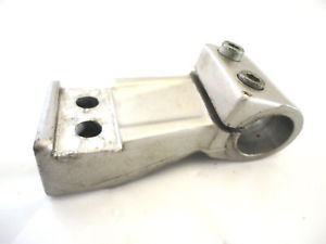

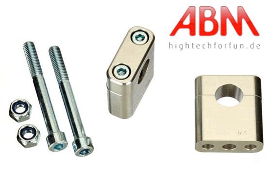

Alt 09.03.2017, 18:35:42   #17
these things are risers (see picture)
Hits:	1678
Größe:	7,6 KB
ID:	26196   Klicke auf die Grafik für eine größere Ansicht
Hits:	1689
Größe:	22,7 KB
Alt 09.03.2017, 18:45:36   #18
luigi
Registriert seit: 26.01.2017
Ort: Milano
Beiträge: 17
Kilometer: 65.000
Yes sure.
My style is the one on the left (two half handle bars).
The total height (from side to side) of mine is 7.5
Is there any taller one already existing? That would be definetively the easiest (and cheapest) option...
Thanks
Luigi
luigi ist offline   Mit Zitat antworten
Alt 09.03.2017, 19:38:01   #19
depends on why you want to change it... most people want a different handlebar on the gs500 because their wrist is hurting.
And that's not only because of the height but because of the angle...
Also... Superbike handlebars are way cooler
Alt 10.03.2017, 09:28:30   #20
If you don´t already got the tallest riser then you can easily change them. The only "problem" that can occur is the hole for the fittings (so they won´t turn). If that´s the case you just drill another hole or cut off the pins of the fittings. With some tape underneath they fit tight enough again and won´t turn.

Alt 10.03.2017, 15:55:00   #22
Check the pictures in the link. They are quite different so that you can keep them apart.
If you need measurement: the tallest riser is 7,5 cm from above the triple clamp to the middle of the hole for the handlebar. (the intermediates have 5,5 cm)
btw: it´s not only the length that differs it´s also the offset, so your back´ll be even more straight.
